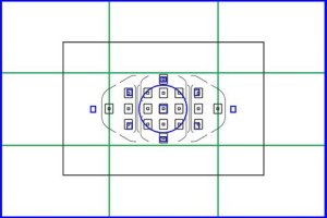

EYEONE said:
But they can't just transplant the 7D system in to the 5D3 because the coverage would be too small.
Funny you should mention that.
Canon could possibly do exactly that - use the 7D's AF sensor at it's current physical size in a FF camera, and because it would have 19 cross-type points it would be 'better' from a marketing standpoint (they'd ignore the reduced spread of the points), people clamoring for a '7D AF in a 5DII upgrade' would be quite happy, Canon would save development costs...and in all honesty, the coverage actually wouldn't be all that much worse than the current 5DII, and the AI Servo performance would get a lot better (denser coverage in the center with more cross-type points).
See below - when you superimpose the 7D AF points (black) at actual size relative to it's frame onto the 5DII's AF points (blue), the vertical extent of the AF points is actually the same, and the points 'closest' to the rule-of-thirds intersections are no further away than they are on the 5DII; only the extreme lateral points get pulled in a bit.
Food for thought....

neuroanatomist said:
Well, point taken. But the 5D2's spread is pretty cramped as it stands. Which makes me think that I'd be fine with 9 points if they spread was wider (and they were cross type).
But come on Neuro, you're just encouraging Canon to be evvvvvvil. ;)

Regardless for Focus points, why dont we see coverage on the 4 intersection points of the rule of thirds grid? Looking at the focus maps posted by John, I see coverage near the grid intersections but non on the intersection points. Heck to make it simple, there should be at least 5 points in every camera, center and 4 grid intersections to start off...

K-amps said:
Regardless for Focus points, why dont we see coverage on the 4 intersection points of the rule of thirds grid? Looking at the focus maps posted by John, I see coverahe near the grid intersections but non on the intersection points. Heck to make it simple, there should be at least 5 points in every camera, center and 4 grid intersections to start off...
There are limitations on how far from the center the AF points can be spread, especially in the vertical dimension. Basically, three reasons:
[list type=decimal]
[*]Limitations on the size of the secondary mirror. Light for AF passes through the semi-transparent part of the main mirror (most is reflected up to the viewfinder), then is reflected off the secondary mirror down to the AF sensor. There is limited space behind the main mirror, based on the necessary geometry (i.e. the main mirror has to be at a 45° angle to the incoming light, and the secondary mirror has to be behind the main mirror and at an angle of 90° to the main mirror, so it's length is limited by the distance between the main mirror and the image sensor).
[*]Distortion. With many lenses, the edges of the frame are subject to distortion (barrel/pincushion), and that reduces the accuracy of phase detect AF.
[*]Vingetting. The AF system needs a certain amount of light to work. Almost all lenses vignette to some degree, meaning there might not be enough light at the edges of the frame. For example, the EF 17-40mm f/4L has >2 stops of vignetting wide open at the wide end - that means at the edges of the frame, the AF sensors would not heve enough light to operate.
[/list]
Still, but the 7D and the 1D IV have points that are almost right over the intersections, and the 1DsIII and 1D X come quite close. Down toward the bottom of this article on EOS AF systems, there's a set of mouse-over comparisons that show the relative AF point spread of the recent xD bodies.
It's worth noting that none of these limitations apply to contrast detect AF, so using LiveView you can autofocus right out to the edge of the frame.
