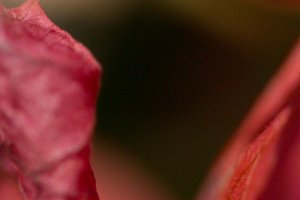

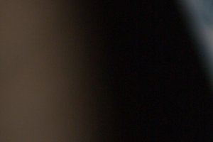

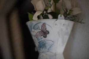

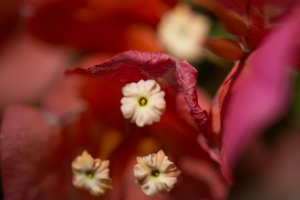

Am I the only one to think that 5d MK3 has very poor performance in shadows, even in low isos like 100 or 200 ? High color noise, weird noise patterns, vertical bands/stripes all without any pushing!!!
Straight out of the box the images look terrible in the shadow areas.
Why is that? I am very disappointed. VERY disappointed ...
Even my poor old 350d did better in that domain...
Is there something wrong with my copy or is it supposed to be like this ?

Now, if you were to re-shoot the shots in your OP with a proper exposure instead of two to three stops under, your result would be better. IMO, the noise you are seeing is normal for that sort of exposure scenario with that camera based on what I have seen from other images I have looked at.

Because do you really think those samples are properly exposed? A great camera cannot compensate for poor photography.
Instead of bashing could you please keep your mouth shut. I tried to be polite before but I am losing my temper. Or t least think before you type. I don't have the right to have a dark underexposed looking image? The shadows should be clean in such situation. I didn't want criticism regarding my images or my technique I just wanted to figure out the noise issue.

After taking a look at your pictures, I suppose you want to create a dreamy look on your photos. However, focus on the flower photo is badly set, also is the exposure. Why did you take it at 1/2000sec at aperture 2.8? Where is the point in this?
Seriously, I have to defend Canon on this: take a look at that black. A camera is not supposed to fix your incorrect exposure! If you need dark images like this one, it would probably work out better if you take shots in RAW and afterwards adjust brightness.
I think that your banding would then be reduced by an awful lot.
Also imho the second shot doesn't look as bad as the first one regarding the banding and noise. I would guess it's because that shot isn't quite as under-exposed as the first one.
