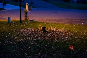

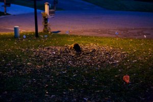

Regarding low light AF w/o flash. I just did a quick test while being distracted by kids so i underexposed,(i did a quick exposure bump in aperture) but the point is how well did the AF acquire focus without hunting. Not a problem with my body. maybe 1/2 second each time I half pressed shutter to acquire focus.
In this series of shots, I simply flipped back and forth between the dog and the cable pole. 4 shots in 6 seconds...they were shot at 25 minutes after sunset (it's not pitch black dark but almost)...with only a little bit of help from a street light (a small street light).
again, this is only about how fast the camera acquired focus, not the IQ of these underexposed shots.

Thanks for spending time on this Northstar! I'm looking forward to receiving the replacement camera and hopefully seeing better performance. It helps to have someone else to compare with.
Since I shoot in both normal indoor and darker indoor/outdoor areas using my older cameras, esp the old trusty 5Dc, I'm comparing to those with regard to what is already normal for me and achievable with older technology. If the 5D3 can't improve on that in the same circumstances or performs worse, than I have to assume either the camera is faulty, everyone is lying or it has a design flaw. What else can I assume, right? I suspect a little bit of everything is possible. I know how to manage my expectations, but what I (and others) have experienced sounds ridiculous.
I've already got the good glass. Canon marketing, various reviews and some other individuals attest that the 5D3 is a miracle camera. So I guess I just want the miracle dammit! ???
Thanks again!
