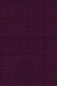

If anyone cares, this is my 5D3.
Lens cap on
35LII, 2.8, 20s, 2sec delay, tripod
Pitch black room
Shot RAW with no in-camera noise reduction
The edit:
PS CC 2017
Camera Raw
+5 stops, +50 whites
WB as shot @ 5200 temp, +5 tint
Exported at 2048px
The image is nearly pitch black until a +3 stop, +50 whites adjustment. At which point you do see some streaking when viewed at 100% and even then you really need to be looking for it.
This took me all of 5min to do the test and make this post.
OMG, stop the presses. When you amplify the heck out of zero signal, you get funky stuff going on with the noise.
That's five minutes of your life you'll never get back…

Here is a second raw file (sorry for the stupid photo I made it in the rush at home) in case someone is interested.
It is shot at -3 2/3
https://www.dropbox.com/s/uz1rj8it9i21xj2/274A7655.CR2?dl=0
