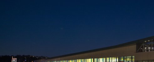

I can see streaking/banding at as low as +1.5 exposure in Photoshop. Just look near the top left.
I can also see streaking at +1 exposure and +50 shadows.
Anyone who says this is acceptable is out to lunch. Sorry.
It's a defect, at least on this camera.

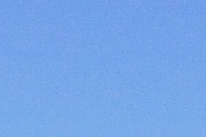

Sorry, I guess don't see what you're talking about with a slight push. So I tried a slightly more than slight push (+4 EV, +100 shadows). Can you please point out these 'lots of horizontal lines right through the sky' that I'm supposed to be seeing?
Edit: If I look at the downsampled image on a small, uncalibrated display like my iPhone, and scroll it up and down rapidly, and really squint, I think that I might be able imagine I see at least one very subtle line... +4 EV, +100 shadows, +squinting, +imagination...and maybe a subtle artifact. Quite the defect, apparently. ::)

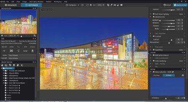

Given the same starting RAW file, my results with DxO Optics Pro, and yours with PS CC, do you stand by your original assertion that the camera is defective?
TimoV said:
I have tested DxO Pro newest version and after disabling all fancy things there, result is the same than Lightroom or DPP... now I also learned that with iPhone this problem is solved ;-)
Sounds like you missed the point that I only (maybe sort of) saw a line when viewing the image on my iPhone. Banding isn't evident on my computer.

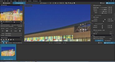

I do wonder what we're doing differently with your file in DxO. Do you see banding in the processed images I posted?
Small files that edited by DxO and posted here, cannot see properly these streaks.
By default, DxO have many settings on that manipulate photos, it looks like it's softening dark sky portion and streaks are not so visible...
The thing with the specific DXO settings however is that the result is not useful.
I try to make something more view-able and the result is not nice. I didn't try prime yet though...
Edit: I tried prime but banding still shows...
Edit2: I have uploaded to drop box the preset settings I used in case someone is interested
https://www.dropbox.com/s/yi4hjs5x4th39kw/2016_12_01_00022.preset?dl=0

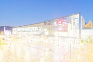

Tron - what's clear is that you are using a completely different bunch of settings to neuro. Your setting everything you can to get artifacts with that exposure push he is doing everything he can to not get them at that exposure push. In the context of this test I'm not sure which is valid!
Do you want an almost completely white picture or something that is viewable. You can download DxO Optics Pro trial edition to test yourself. I posted the prefix file so I am open to suggestions. But first and foremost the final picture should be viewable not something almost totally white. And since I do have a 5D4 too I really want this to work!
tron said:
Sorry tron not sure what you mean by completely white picture, neuro isn't doing that. Perhaps he would be good enough to post his preset. My interest in all this just that I'm thinking of getting one so I'm trying to get a resolution in my mind about what's going on here. I'm not criticising anyone's concerns.
