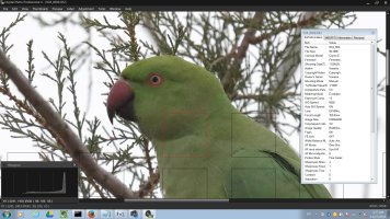

Allow me to deviate from the thread topic a little. Attached is a screeshot from the latest DPP of a photo a 100% magnification. ISO was 8000. Not bad :)

Hallelujah! eventually we can put this Lens Cap Shooter's Diary saga away and return to our business of taking meaningful photos :))
Thanks Canon for listening and standing by your products. I will be looking to acquire 5D Mark IV later in 2017 as soon as prices were settled a bit.
For now, I purchased second 6D body and that will do me in the interim.
ZachOly said:
I just tested the "lens cap" shots from @PixelTrawler
The difference between FW 1.01 and 1.02 shows a massive improvement in streaking. FW 1.02 is producing random noise like you'd expect to see after a push.

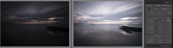

Here is a 3.3ev lift. At this point there are faint lines visible in the lower left hand side.
But its a very big lift on a very dark underexposed image. I'm very happy with this example. Thats very impressive detail recovery on a scene of what I found so far to be the worst for showing any signs of banding.
This is with a 10ND B&W filter that murders detail in the foreground if the exposure is wrong.
Thats a total write off image thats almost usable. If I spent time on that image I could get something out of it.
I would bin a similar image on my 5D3.
I'm also pretty sure its better than my first 5D4, I was less impressed with that one. I'm convinced they are not all exactly equal.
If anyone wants that raw to screw around with PM me.
