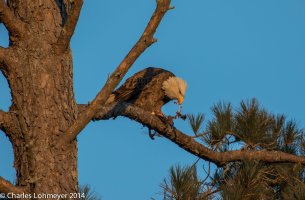

7d mk2 seems very soft?
The photo you post is indeed soft BUT it is so soft that I can't believe it is the camera. There is something else wrong which am sure you will figure out eventually. This is not a FF vs crop issue. AFMA or processing seems to be the issue.

Is your opinion of the 7DII based on personal experience, or based on the images in this thread? The first two of those three posters solved their 'my 7DII is soft' issue, one with appropriate post-processing, the other with a lens adjustment (AFMA, presumably). The third, the eagles a couple of posts up on this page, the first of which is a front-focused image (also likely an AFMA issue) with abysmal white balance (or maybe it's perfectly accurate...if the bald eagle just took a swim in a vat of Tang).

It seemed to me that the fork in the branch casting a shadow on the eagle's back suggests a higher sun angle than 'golden hour'. Still, my comment was a bit off-color and I apologize (for the comment and the bad pun).
Regardless, it appears front-focused - the bark on the trunk appears sharper than that on the branch where the eagle is perched. I'd test focus adjustment before questioning the sharpness of a new camera on the first day of shooting.
The suggestion that the photos are front focused is exactly the type of feedback I was looking for. The camera is only three days old and it has not been to the shop to have the AFMA work done yet. As for the "tang" comment I will bite my tongue! It just so happens that this photo was taken very early in the morning and the sun was shining directly on this tree where the eagle was feasting. No matter what I did with white balance or color adjustment the orange tint will not go away.
Not sure about 'been to the shop for AFMA'? AMFA is something you do yourself, at home. If you're still having issues after AFMA, the body (and/or lens) may need service. But backing up a step, there's an easy way to get a read on whether AFMA is going to help for a given lens+body combo. Use a stable tripod and choose a flat, high contrast target (a sheet of newsprint taped to a wall works), take a set of live view shots, then a set of phase (viewfinder) AF shots (set of = 5 or more), pick the sharpest of each and if LV is sharper, AFMA can help.
Sorry again about the Tang comment. :-[ As for the WB, what's your RAW converter? Here's a quick attempt of mine...

There is a shop where I live that I use to do the AFMA. After reading through how to do this I felt more comfortable letting an expert do it. They adjusted my original 7D to the same lens I used on the photos that I attached.
I am using Lightroom to convert my raw. I have only been using this for a few months so I do have a lot to learn. I would to hear how you made the orange tones go away.
I use DxO Optics Pro. But I don't think that mattered for this - I have to confess, all I did was use the 'dropper' on one of the more weathered/neutral-looking patches of bark on the trunk. Perhaps I should have said a really quick attempt of mine? ;)
I also downloaded it and corrected the color in lightroom. I adjusted the head feathers to be white.
It appears to me that the camera focused on the crossing branch above the back of the bird. I'd check focus on a flat wall, its really easy to have a camera focus on the wrong area.
I assume that there was a high ISO, there is a lot of noise, so the fine detail is lost.

I too am questioning the sharpness on my new 7D II. Today was the first day of shooting with this camera and here a re a few examples.
Ha...you're joking right? That eagle's eye look plenty sharp to me.
Where was the focus point? It does look like the branch and trunk in front of him are sharp too, and his body is not, which suggests the focus point might have caught that tree branch in front of him but the depth of field was great enough to get his eye in focus, but not his body? Just a guess.
I also did an edit for you....simply food for thought.
