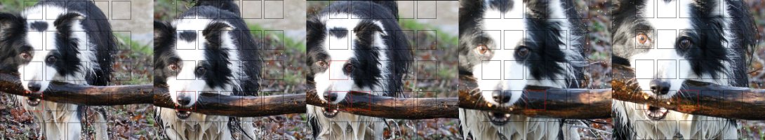

And here is a strip of two short bursts.
#1 is bad, #2 is bad, #3 is getting there, #4 is bad and #5 is also bad.
AI Servo 1st Image priority and 2nd Image priority are both set to "Focus".
I have tried with AF Case 1 and Case 2, I think I get slightly better results with Case 1.
Sooooo, am I expecting too much yet again. All I have been trying
to do is have my dog Dave running towards me, starting at about 50M away
(me crouched down) firing off a few high-speed bursts and expecting to get
more than about 10% of the shots in Focus.
In this case I wonder if its the fact that he's coming towards me, and he is black and white
causing the problems? OTOH, the AF is not hunting to achieve focus, most of the time the camera
gets off a long burst at high speed, which I find to be very fast.
And one more thing. I know Zone AF will mean I cannot control where Focus is, but (out of desperation),
I'm giving the Camera and Lens the opportunity to chose a spot and then nail it, and I think it is chosing
the spot OK, but then not focusing correctly.
Ideas?
Cheers Brian

sure I understand that. I have tried the various AF Point expansion modes, and using them does get me better results. But my problem is more that AF achieves Focus on one of the points in use, but the area under that point is not in focus.
Going to Zone AF in some of the shots was to say, "OK I'll let the camera decide what it can focus on (plenty of contrast there maybe) and then that point will be sharp".
But that is not the case.
Cheers Brian

Hi Jason,
thanks, I'll try to answer your questions and suggestions:
Try using Case 2 without any mods,
Tried Case 1 and 2 mainly, no mods.
make sure you are using AI Servo, High Speed..use single center point AF and or Expansion,
Mainly AI Servo, high speed, various AF points tried
mode 3/2 on the Lens.
Not tried this yet. Thanks.
..also might want to try Shutter Priority as opposed to Aperture Priority...around 1/800 - 1/1200 for starters, auto ISO up to 3200 max or select manually...
OK I would understand that for very fast moving subjects. I think I am fast enough as there is usualy no motion
blur I can see. I find it better to keep the ISO down on the 7D MKII, but its worth a try.
Focus Priority is ok but I use the other..I want that moment weather or not its perfect.. My AF is tied to my shutter button, I don't use the back focus button for action..(half press begins focus and tracking) click to pic..
OK but that should really affect just the first shot in a burst. I tried back-button for a while but didn't stay with it.
I shot motorcycles coming at me at about 80-120 MPH last week and my tracking /AF was spot on....also make sure you are shooting with Large raw or large .jpg files.... check your focus range switch too...#1 3.22' to infinity or #2 for 10' to infinity..it will acquire focus faster depending on how close your dog is at the start of your photos...(50M #2) mode 3 or 2 for the stabilizer mode...and take everything back to default on the back focus/front focus... unless you are 100% sure you are using the above settings correctly switch it back...
Large RAw, for the best quality, Fast CF card, and the frame rate is very impressive. Problem was present without any AFMA settings, but I can try taking them off again.
try not using Zone....your camera is taking a guess at what to track, you need to tell it what to start with and know for sure where that AF point is at... and on the 100-400 if its not spot while using a low Aperture it will throw off the focus area...
I think I'll also take a look at the usable AF points with this lens at low aperture and see if that can explain what is happening. Thanks for your suggestions.
Cheers Brian
