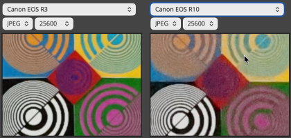

Benefits of collecting more total light, and not just at base ISO. At lower ISOs, the DR advantage is what is most noticeable - presumably what you mean by 'advantage in IQ'. At the other end of the ISO scale, the ~1.3 stops more light collected by the FF camera benefits not only DR but also image noise directly. I routinely use my R1 at ISO 25,600, a setting I wouldn't even consider with an APS-C camera.
(Showing the R3 because DPR's comparator doesn't have the R1, but I also routinely used the R3 at ISO 25,600.)

Also, at the other end of the ISO scale the FF camera achieves better noise performance by ~1.3 stops. I routinely use my R1 at ISO 25,600, a setting I wouldn't even consider with an APS-C camera.
