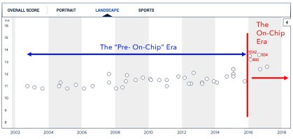

Can you please provide a link for that? This is the first time I've read such information and I'd like to know more. Thanks.
Really crudely, I presume they are referring to the seemingly snail-paced increases in DR before moving to on-chip ADC like the competitors use.
See attached -- this is DXO-reported DR for all APS-C and FF Canon sensors. It's not exactly 12.0 across the board, but you get the idea from this. In short, the move to on-chip gave three recent refreshes a 1.5-1.7 EV bump, which is pretty dramatic given the prior tiny bumps we've seen over the last 15 years. This is just base ISO, so some folks (studio, landscape) were probably more demanding/pumped about this than others (most general shooters).
Apologies on such a crude crude 'era' bucketing -- last I checked, my 5D3 didn't come off the same fab as a 2003 1Ds Mk I ::), but I'm just bucketing for the sake of simplicity here.
- A
ahsanford said:
- A
I misunderstood x-vision's answer. I read it as if DxO had already over 20 bodies of 6D II camera, stripped them down and found off-chip ADC. I didn't get that he was in fact speaking in general and not particularly of 6D II itself. Sorry about that.
DxO allows you to compare up to three cameras at a time.
Here is a link that compares the pixel-level dynamic range (DR) of the 20D, 5DII and 5DIII.
https://www.dxomark.com/Cameras/Compare/Side-by-side/Canon-EOS-5D-Mark-III-versus-Canon-EOS-5D-Mark-II-versus-Canon-EOS-20D___795_483_281
Here is the summary:
  • 20D, a 1.6x crop camera from 2005: 10.95 EV of DR
  • 5DII, a FF camera from 2008: 10.95 EV of DR
  • 5DIII, a FF camera from 2012: 11.16 EV of DR
That is, a 2005 crop camera (the 20D) has essentially the same DR as a 2012 FF camera (at the pixel level).
Btw, let me correct my initial statement:
It's the same signature 11-stop pixel-level DR, not 12-stop.
As a Canon fanboy, I was subconsciously giving Canon too much credit :o 8).
