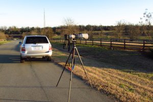

I do not know how to shoot the stars with Wide Angle Lens yet, But I use my EF 600 mm. shoot the Moon and the Comet ( First time in my life) = The Comet Panstars - 3/12/2013. I have Learn From the PRO that when we use the Long Tel. Lens, We must set the Super Fast Shutter Speed such as 1/500 Sec. to not let the moon Movement Blur.
Yes, I set My Canon 5D MK II at the TV.( shutter Speed Priority) at 1/ 500 sec, Set ISO = 2500 and the Camera will auto set F = 4.0.
It's works.
Enjoy
Surapon
