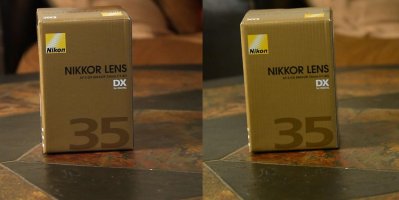

Mikael, you always seem eager to post DR scenarios which favor Nikon. We know you have a D800, 5DII, and QPcard. Do you happen to have a light source with a constant, known color temperature? Actually, the packaging if a new bulb should indicate the temp in Kelvin units, and if you take shots one after another, it's constant enough. Perhaps you'd be willing to shoot that QPcard with both cameras, and show us a straight-out-of-camera JPG with the WB set to the color temp stated on the bulb packaging? Just a thought...
Seriously, Mikael, this would be very interesting to see. Any possibility you could tack this onto your To-Do list?
Here is a frame grab of the actual video - Canon 60D on the left, Nikon D7100 on the right. The Nikon image has an unattractive cast to it - not sure if you classify it as yellow or green. The Canon image is more accurate color wise and produces a slightly sharper picture, but there is moire present on the box in the Canon 60D video that's not present on the D7100 video.
Going back to my original photos of the LCD Screens - realize that the soft image you see on the Nikon D7100 LCD Screen is as good as it gets - I was focusing using a Zacuto Z-Finder and the focus was accurate - the Nikon in zoom mode produces an unacceptably soft image on the LCD that is pathetic for focusing.

No more experiments for me - I sold the Nikon D7100 the next day and decided to stick with Canon.
The Nikon D7100 had all of the default settings and I believe it was on Standard Profile. If there's a way to get the Live View Zoom mode to work better for focusing, I'd like to know about it.
