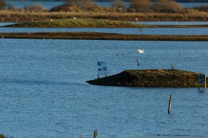

I am going to eat some of my words. Yesterday, at the end of some miserable attempts to photograph birds at a reserve, I stopped off at the visitor centre where you could see a Swarovski target that had been placed for an exhibition and had been left behind, a 100 or so metres away. Here is a shot of the target with 420mm on the 5DIII, to get a feel for the scene. Next, is an unsharpened crop from RAW of the target with the 100-400mm on the 7DII at 400mm f/5.6 (the crop is close to 400 px wide at 100%). Below that is at f/8 and 560mm (about 560 px wide). At the bottom it's at 800mm f/11 using live view (close to 800 px wide). On going from 400mm to 500mm, there is a little improvement in resolution. But, on going to 800mm, it becomes much clearer and you can even read the numbers in the circle. I was so flabbergasted on getting home, that I checked my focus just in case live view was better than AF - it wasn't. It is just that you need to get to 800mm to resolve the fine details, and below that they are merged (below the Nyqvist limit).

I identified the island and the visitors centre on Google Earth, got their co-ordinates and calculate the distance to be 243 m. From that and the size of the image, I calculate the target was 1m x 1.3m. The lines in the lettering are only a couple of pixels wide with the 800mm lens.
Oops, that's some difference. I trust you and Google more in this case; those numbers comes out a little bit more real and trustworthy compared to the EXIF.
