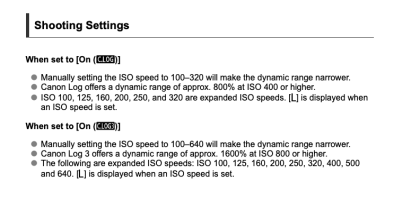

ISO 400 in LOG video.
ISO 800 in RAW video.
ISO 200 in RAW photo.
ISO invariant at 800.
Don't use the low modes (L100) for anything.
With LOG 3 video it is also ISO 800, ISO 400 is still enabled, but it changes to an 'L' setting
So 800 looks to be the native ISO for video with Canon Log 3 or with RAW video for Canon Log 2 conversion.

@Refraction why ISO 400?
On my R I used ISO 400 because I read somewhere the gave the best dynamic range. On the R5 I have always used ISO 800 for log again because I read somewhere it gave the best dynamic range for the R5 sensor.
Do not ask me to back that up with anything because there is a high possibility that was all pulled out of thin air:)
I agree on CLOG 3 in my tests
You are correct. This from the R5 manual, updated edition.
