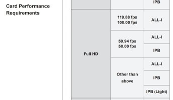

I’ve seen a blog (not by JP) outlining the weirdness of the 1080 120fps situation with the R5. Apparently it was mentioned in Canon documentation as an included spec at one stage but subsequently and somewhat mysteriously disappeared. More in the line of conspiracy than rumour. Either way it is an odd omission and one that would be great to see rectified.
Was it on the Canon Community forum? I wrote that. I documented it because it was listed in multiple places as a feature. Then it was pulled after the camera was announced.
All the images attached are directly from official canon USA websites.
thank you for this, so I guess they had some problems and will return the option...Would love that my R5 is able to do it.
