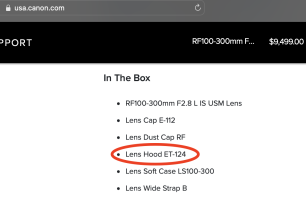

How many times does it need to be said that the hood will be included, as it is with all L-series lenses? Canon sells replacement hoods for L-series lenses, because sh!t happens. If I ever need one for my 600/4 II, it will cost $700.
Not that it's your business, but my 'gear fund' bank account balance is more than sufficient to cover the $9.5K cost if accurate (even after the balance dips by $2K from my unfulfilled preorders for the EL-5 and R8). I'm fortunate that money is not much of a limiting factor for my purchases, as is evident from my gear list (which I'll need to update at some point, since I've sold the 1D X and EOS R, and bought an RF 100-400, RF 24/1.8 and a Vixia HF G60 camcorder since the last update; I also just bought an underwater photo/lighting setup for diving so perhaps I'll add that).
ok genius if the hood is included why did they mention the price of it then?
  • Haha
Jul 21, 2010
29,833
10,427
Because sometimes people lose or damage a lens hood. Canon also sells the E-112 Lens Cap for $25. Do you think that's because they don't include a front lens cap with the lens? It's great that we have genius brilliant smart members like you contributing here!
At least you did your research before posting something that made you look foolish.
