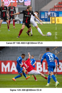

Was a bit lacy so i was only able to find an image at 330mm f/5.6 to compare with an image at 300mm f/2.8Thanks for the feedback Rooster.

Thanks Rooster but I kind of feel this might prove my point, at least to me if no-one else. Intellectually I know f/2.8 should have twice the OOF circle with four times the area but the DOF seems to work in both to separate the action and background, and the noise also seems to be acceptable in both. This is really a question of personal opinion of course, but...Was a bit lacy so i was only able to find an image at 330mm f/5.6 to compare with an image at 300mm f/2.8
You can see, that the DOF is noticable smaller at 2.8. Background blur at 5.6 is noticable, but not so strong. And the background is further away than in the second image.
ISO was at 2.500 in the first image and ISO 5.000 in the second. The noise you see in the frist image ist heavy rain ;-)
Shutter Speed: 1/2500 first image, 1/3200 second image

Thanks Rooster but I kind of feel this might prove my point, at least to me if no-one else. Intellectually I know f/5.6 should have twice the OOF circle with four times the area but the DOF seems to work in both to separate the action and background, and the noise also seems to be acceptable in both. This is really a question of personal opinion of course, but...
Well, when you need background separation than the difference in aperture is a big deal.I'm using my Sigma 120-300 again on sunday during a match. Maybe i find time to shoot a not moving subject in the same place from the same disctance. Here the difference betwenn 2.8 and 5.6 will be more noticable. DOF/Background blur also has a lot to with distance between photographer and subject.
And of course, you get some separation from the background with 5.6. But it's not as good a creamy as with 2.8.

In my example: the second picture was shot at ISO 5000 with a shutter speed of 1/3200. If i want to have the same shutter speed with a 5.6 lense, the ISO would have been at ISO 20000.Thanks Rooster but I kind of feel this might prove my point, at least to me if no-one else. Intellectually I know f/5.6 should have twice the OOF circle with four times the area but the DOF seems to work in both to separate the action and background, and the noise also seems to be acceptable in both. This is really a question of personal opinion of course, but...
