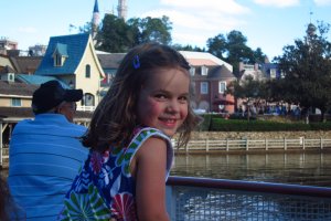

Disney World. Shot with s95 after receiving it 24 hours before. Not sure what the white dots are in her eyes? Also, cut off her arm, but at 3.5 years old, did not have time to compose.
White dots just look like catchlights, reflections from something bright to the side or behind you. Was this shot jpg? Lots of CA around the trees and towers, more than I'm used to seeing in my S95 RAW shots processed with DxO.

I'll echo neuro's thoughts (catch light and tons of CA/ghosting). There is also a white-hot pixel on her left eyebrow. Something looks very strange about this picture. Can you upload an as-shot jpg conversion? What settings were you using in LR, because everything in the background is ghosted (not just highlight/shadow transitions, but all the mid-tone transitions as well)?
When you say strange, are you referring to possible camera issue?

In the unedited shot, the CA is still there but less evident. The saturation deepened the blue of the sky, but really enhanced the CA...not a desirable effect, IMO.
Yes, I was referring to a camera issue, not your composition or anything. I agree with neuro that the CA is still present in the as-shot, but the contrast/saturation boost does exacerbate the problem. I'd believe in the second picture the CA is not as bad since it is not backlit (like the first).
