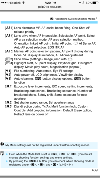

Has anyone tried saving different AFMA to a lens in the custom modes C1, C2, C3? I've only ever tested lenses at the one recommended distance with FoCal, but I've been thinking about testing my 100-400 at very long range, say 200 meters or so (with and without the 1.4x). The challenge will be to find a good spot to do the testing.
The goal is to create a C1 crop mode setting on my 5Ds and have the AF tuned for long distance and then the AF tuned for standard distances in all other settings. I'd then be able to have the AF adjusted at multiple ranges. If my understanding of the manual is correct, this should work.

I wasn't sure, but page 439 of the 5Ds manual sure made it seem like it was something that could be registered to C#. I think I have a screen shot of the page attached here, I'm on my phone. If it didn't work I'll edit the post later.

Interesting. I'd try a test to see if the values are saved. Consider, if you get a new lens or retest an old one, you'd have to modify the AFMA values in a regular mode and in each C# mode. I suspect what's saved with the C# setting is the main setting (disable / adjust all / adjust by lens), but not the lens-specific values. That's how it's described for the 1D X II:
[AF5] AF point selection pattern, AF point display during focus, Viewfinder display illumination, AF status in viewfinder, AF Microadjustment (excluding the adjustment amount)
Try setting a value and registering C1, then set a different value for that lens and register C2, then go back to C1 and see if it reports the old or the new value. Please let us know how it goes!

So, to quote page 437, "You can register current camera settings, such as the shooting mode, menu functions, and custom function settings, as custom shooting modes under the mode dials C1, C2, C3 positions." Once a custom shooting mode is registered "the current camera settings (page 438-439) will be registered under the mode dial's C# position".
Page 439 is the one attached above, and it includes the AF Microadjustment. The way this is written implies what I hoped to do is possible, however, I just tested it and as Neuro stated, the AFMA was global. Disappointing. Is this a case of a poorly written manual that is misleading me, or is it an intended feature that doesn't work?

Neuro, I was writing my last post when you replied. I had tested it as you suggested, registered C1 with a +10 AFMA, switch back to Av mode, changed the AFMA to +5 and registered C2. The AFMA ends up being +5 for both C1 and C2.

I'd say the former, a poorly written manual. As I suggested, it wouldn't make sense to require users to add/change a lens-specific value in multiple places.
I just did a second test and your suspicion was correct. I could set it up so that AFMA was disabled in C1 and enabled with a value in C2.
