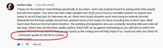

My only concern is the R6. It is hit the hardest since it has no full sensor 4K modes that don't overheat.
I don't personally know many videographers besides event videographers who record more than 2 minutes at a time. I personally don't when making commercials etc.
If they apply this same fix to the R6, so I can record lots of short clips, I will be ordering two. If not, looks like I will be going Sony A7S3 or A7IV when it comes out.
Anyone preordered the R6 here?
screenshot taken from nolife youtube channel ;)
