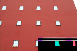

Hello,
I have the same problem that I can see the lower right corner of a big amount of pictures corrupted.
I import since very ling time the pictures directly from the card into Lightroom. I never had any problem like that in the past with my 5D III.
I did use DDP to check the file on the card and on the hard disk, both have the same problem.
I did check the md5 and of course it is the same in the card and in the hard disk. seems I don't have version of the picture that has no problem.
iMac with 10.11.5 and latest Version of Photoshop, Lightroom or DDP.
CFast card and reader of SanDisk which did come with the camera together.
just some thought from my side
Card error? Why for random picture the corrupted size should be always the same. if the card would have a problem, I would expect another behavior.
for the future I will try some things more. I will write the RAWs on the CF and on the CFast Card.
Lets see what will happen.
privatebydesign I did check your files at my computer with DDP. good files are good, the bad files are bad.
