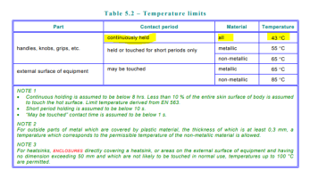

It is not his opinion... It is based off of at the very least the ECMA-287 Standard. I believe that Europe has adopted even stricter standards for electronics and wearables.
Anything that is continuously held by a non skilled person should be limited to a surface temperature of 43°C and below.
Canon's design is likely more aimed at keeping that 82°C away from the external surface then it is about cooling the camera.
