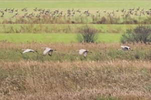

Certainly you must realize that for lots of situations (birds and wildlife come immediately to mind) the subject is very small in your image despite shooting at the maximum focal length. Let me know when Canon releases that 2000mm or 2500mm focal length lens, but until then, I will need to crop. These Sandhill Cranes were just over a half mile away. I think I was using the correct focal length!! (400mm lens with 2x TC using a MFT camera (with 2x crop factor). And I still had to crop.
