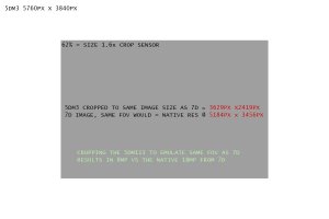

There are several points to make, first is I am a little maths challenged too and agree, it doesn't make sense, but my empirical results illustrate my point.
Secondly, I never said it will never make a difference, but in my empirical testing (on older generation bodies but same theory) I found it didn't make enough of a difference to be noticeable in big prints even in optimal conditions set up to favour the crop camera. I would love Bob or Lee Jay to actually come along with some decent examples illustrating their beliefs, I have done so for mine. I am not saying 'I am right you are all wrong', I am saying 'I found this to be true, has anybody doing the same comparison found the same?' and several, like Neuro, have. I have never seen anybody post direct comparison images that illustrate a very different result, certainly after optimal processing at any kind of actual reproduction size there never seems to be a difference.
Third, as I have always said, the feature set of a crop camera might well make it a better camera anyway, things like AF, fps, cost etc can't be ignored.
Fourth, my crops are actually set up to favour the crop camera in iso and aperture etc, but also I upsized the ff file to match the crop file pixel for pixel to 'level the playing field' for comparison purposes, this should favour the crop camera even more.
But in the end I base my buying decisions on empirical results, I can't see $1,800 worth of difference in those >100% crops to warrant the expense, and I was happy to pay $3,750 for a 300 f2.8 over a $1,455 300 f4.

Lee Jay said:
What your test shows is that the later generation is better. No surprise there.
The 20D and the 5D were the same generation, and the T2i was really not much better per unit of sensor area, except for the higher pixel count.
I'm sure the better light-gathering capability of the T2i's pixels is irrelevant...at least insofar as ignoring it helps support your conclusion.

You missed a big point in the crops jepast. The FF crop is upsized to 18MP, there is no 18mp - 8mp advantage, I am, effectively, 'giving up' nothing.
"You missed a big point in the crops jepast. The FF crop is upsized to 18MP, there is no 18mp - 8mp advantage, I am, effectively, 'giving up' nothing."
If you think you are giving up nothing go take both cameras, put on an identical lens and take a picture of an object that is far away, proceed to crop the shot from the 5DMIII to match the shot from the 7D, and then print them both at 30"x40"...
You need your empirical evidence, go do that.

I did, and I am showing you a crop of over 100% magnification of that print file.
I used the same 300mm f2.8 IS on both cameras (actually I left the lens on the tripod and just changed bodies where it was), manual focus via live view, f5.6, iso200 (which favours the crop camera), wireless flash for maximum contrast, massive tripod, cable release etc etc.

I don't know if you forgot to attach an image.. but I am with you, at the end of the day, in order to compare, we'll just be pixel peeping, the very thing I think we both agree is pointless and obnoxious. The images are what's important. I already know that the images will look almost identical despite the difference of resolution, until we get to 100% crops and pixel peeping, and nobody wants that.

A decrease in pixel size is the same as an increase in focal length. Here's proof you continue to ignore.
