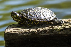

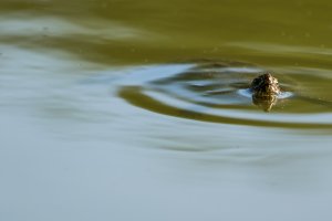

That issue with AF inconsistency seems to be very real. I had been considering getting a 7DII soon, so I rented one for the last weekend and gave it a tryout in wildlife enviroment I'm familiar with, so I could have a fair comparison with my 6D that I have been using for years. Guess what. Despite number of AF points in 6d, lacking of more than one cross type af point, focus-and-recompose technique, I found 6D far more reliable and consistent. It did not become obvious until pixel peeping, and most can say there is no visible difference between the two for most uses. But it is what it is. Decide yourself.
Long story short, there is a local lake where I usually go to photograph pond turtles every month. Animals taken shots of were practically stationary, high shutter speed used with the same 400 5.6 L lens. As you can see, on the 6D- despite of focus and recompose- head is tack sharp, even at 100%. On the 7D II, thanks to wide spread coverage, af was dead on the head, however it is out of focus, seems blurry, which first made think it was a slight motion blur. But it wasn't. I shot a sequence of 8 shots (back-focus button on, iTR enabled) and most of them looked even worse. Reflection of the head looks in focus, instead.
Rutting season is on the horizon, and my plan was to get a better wildlife performer camera, but based on these experiences I will think twice about buying a 7D II.

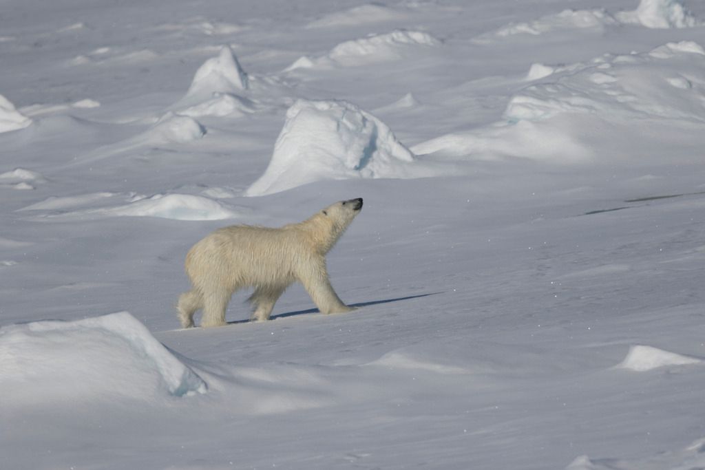

Mancubus said:
I've had EXACTLY the same problem with my 7D2. ... All my shots still had exactly the same kind of softness you showed on the polar bear.

Very interesting, so we have two people starting a thread with same problems. As it looks, many agree and find out that they also suffer from same softness. When I get the OP here right, it is not only a af-problem, it is having soft pics most of the time with telephot-lens, like the polar bear example.
This is exactly my conclusion comparing my 6D with my 7DII as well. 6D's AF is lacking in many ways (lack of AF point coverage, really slow AI servo, etc), but when it says it acquired focus, it really acquired focus. When the 7DII says it acquired focus, I simply don't know...
I really don't want to give up on my 7DII -- it provides functionality that's otherwise only available with the 1D series and, more importantly, I *know* it's capable of great IQ and sharpness (as seen here with the sample pic I posted in the other thread). But the inconsistency is prevalent and frustrating enough to make me want to give up on it as well.
When comparing your last picture (7DII crop) to the peaches or the bullfinch pictures in the other thread (http://www.canonrumors.com/forum/index.php?topic=30160.30), I´ll guess that it is the same issue. AF really locked on spot, but soft results. I tested this with static objects (peaches) to find out any difference between af, mf, liveview. But the difference was little.

Go Wild said:
neuroanatomist said:
One other thing to look for – when the pics are soft, are they sharp anywhere? I'm getting at, is the focus off or is the whole image soft?
Yes, i got the 2 situations, sometimes the sharp point appears in a zone out of the AF point selected, and other situations the image just get soft.
Let me put here 2 examples:
In both examples i got AF in back button and used the center point expanded. Both situations also AI SERVO was used
in example 1:
this photos were taken with 1/3200 F7.1 - Paralel movement to the camera, and slow movement of the animal. Camera placed in sturdy tripod and without movement. Easy shot! The results are this:
same photo with crop:
same photo with bigger crop:
Now lets see an example of the 5D markIII. Same settings, same situation, altough in this the bear was more quiet, but in the other it was moving really slow.
with crop:
with bigger crop:
Not sure if this was mentioned, but at f8, you are past DLA. DLA is f/6.6 on the 7D MK II. Crop sensors can't be stopped down the same as a FF or you will see diffraction kick in. Your case may be diffraction or missed focus or maybe both.
DLA: http://www.the-digital-picture.com/Reviews/Canon-EOS-7D-Mark-II.aspx
You really should not compare the two scenarios. The 7D MK II shot only has the head sticking out of the water but the 6D test shot is a stationary turtle on a log. Shoot like subject and then compare.
DLA is not a sharp cut-off value. There is a slow loss of resolution as the f-number increases, and there is hardly any discernible deterioration in resolution on going from f/5.6 to f/8. Indeed, many lenses give sharper results at f/8 on the 7D II (or 5DS R) than at f/5.6.
Nope. I consider both scenarios stationary. Actually, when I photographed the turtle on a log with the 6D the wind was slightly blowing, so the log was slowely spinning in one way. Did not make any difference due to fast shutter speed. However, the turtles head on top of the water shot by 7D II was practically motionless and as you could have read I shot a sequence of 8 shots, back button af on, iTR on, high speed, af on the head... all of them was oof like that or even worse.
