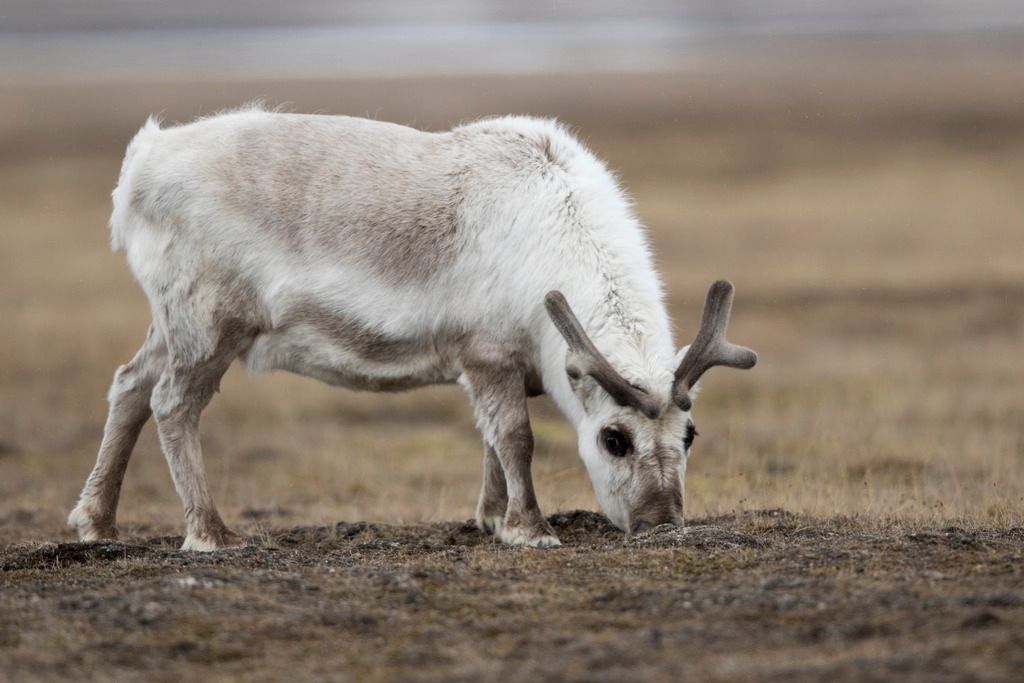

Yes i look at it, and yes, i have considered so many times that was a AFMA problem. I have lost hundreds of hours in AFMA and i do think it can also be a problem of AFMA.
However....2 considerations. If you see the soil, not even the soil is sharp! If it was simply a problem of AFMA and the focus hit another point, that point should be sharp. And it just don´t happens at all, not in this example, and not also in every situations.
I use a 500mm F4 IS L II with the 7D MKII and i tryed everything. The afma that gave me better results was +3 but no even that solve the problem so i tried with everyones....+5 (seems like this one is the better with the teleconverter), +7, +1, +2 and so on....With Tamron lenses well.....it´s the hell on heart! With tamron 90mmF2.8 VC i got a AFMA of +18 and even so, at distances bigger than 20 meters it just give me auful images!! This is because i sometimes use this lens in weddings.
Look at the grass in the foreground, at the extreme bottom of the screenshot below. Although your subject is not in sharp focus, the grass in front appears to be sharp. Certainly, it's sharper than the subject, which indicates that your DoF is in front of where you want it to be. It's even more evident in this image – you can clearly see that the that the focal plane is running in front of the subject (your crop of the image actually crops out the plane of sharp focus). The prior image that you call 'in focus' (#3 of the 10) is still front-focused, but the animal's head extends into the DoF (which at 500mm f/4 is pretty thin – I'd estimate less than 2 feet of DoF at the distance for that series).
As Mikehit stated, you're lens is front-focusing. The fact that a positive AFMA seems to help is consistent with that. Based on your description of trying AFMA values, it seems more like you've just fiddled with a few settings rather than systematically determining the appropriate value (e.g. with Reikan FoCal or careful manual testing).

If you look at the soil, in almost every case it seems the grass is in focus in front of the reindeer. This suggests a front focus problem.

Honestly I don't see any part of those examples in focus, would be better to see the original raw files though.
@ go wild was IS on or off? Wondering if there is something faulty between camera and lens rather than AF as such
I do believe part of the explanation is front focusing. Further, one should be aware that the smaller pixels on the 7DII is much more demanding on the lenses, than larger pixels, such as on a 5DIII.
