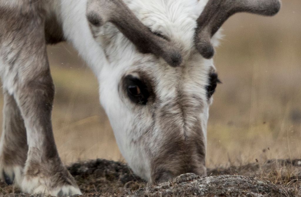

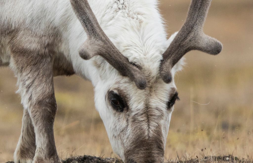

Let me put you another example:
In this situation, i was shooting in a sturdy tripod, in a confortable position, no fast movements, the reindeer was walking and eating but in a slow movement. I got enough light, i was shooting at 1/2000 F4 no teleconverter. The animal was close to me, the photos are without cropping. I was not interested in getting the whole body in focus so i choose F4 to give me only the head in focus.
I shot 10 frames. only the 3rd one was in focus and even that one is not good. So please tell me....in this scenario, is it my fault?? And is it my fault that it happens every, every, every time the same in lots of different situations?? And is it normal that when i shoot with other cameras nothing of this happens??? So sorry....1 year is enought.....i am not blaiming myself anymore!!
Examples:
1 . original image, third one taken in 10 photos. Just some correction in luminosity.
2 - Same image cropped
Now another one representative of the another 9 photos taken. They are like this.
3 - Original photo
4 - Cropped photo
if i don´t see the setting i would say that this is motion blur due to slow shutter speed. The problem is....that the shutter speed was 1/2000!!!

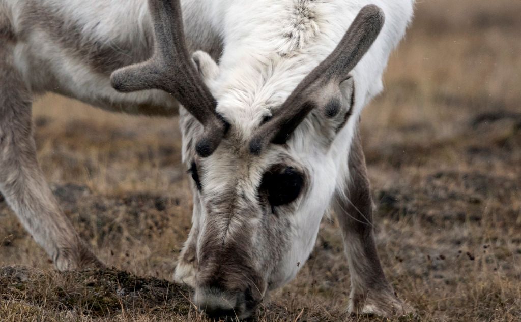

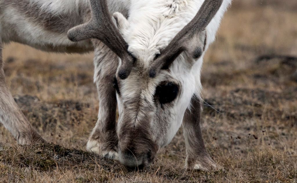

And i put one more, again slow movement, good light, 1/2000 shutterspeed....again around 10 shots, not even 1 got good!
I only going to put the cropped image:
1 - This is the better one even not good:
2 - This is the following one, just 0,2 secs after and the other 8 ones also like this:
If you look at the soil, in almost every case it seems the grass is in focus in front of the reindeer. This suggests a front focus problem.
Yes i look at it, and yes, i have considered so many times that was a AFMA problem. I have lost hundreds of hours in AFMA and i do think it can also be a problem of AFMA.
However....2 considerations. If you see the soil, not even the soil is sharp! If it was simply a problem of AFMA and the focus hit another point, that point should be sharp. And it just don´t happens at all, not in this example, and not also in every situations.
I use a 500mm F4 IS L II with the 7D MKII and i tryed everything. The afma that gave me better results was +3 but no even that solve the problem so i tried with everyones....+5 (seems like this one is the better with the teleconverter), +7, +1, +2 and so on....With Tamron lenses well.....it´s the hell on heart! With tamron 90mmF2.8 VC i got a AFMA of +18 and even so, at distances bigger than 20 meters it just give me auful images!! This is because i sometimes use this lens in weddings.
This is just insane and of course get´s you mad when you splash about 10.000 euros in a combo! This never happen to me with previous Canon bodys, and i use the previous lens Canon 500mm F4 series 1 with Canon 5d markII and canon 5d markIII...
Well...i just wish i could afford a 1D series body. In the meantime, i am going to try once again to do an AFMA to see if i get more consistan results and i will send the camera to Canon to see what they say.
However, i do think the camera have some shaking problem inside, you can see in the polar bears photos, the reflexions in the snow, the light is "dancing" like it was a slow shutterspeed.
In resume....i am sad and i have lost a huge amount of time trying to put this camera working, and most important....i have lost a huge amount of photos...photos that i wont be able to do at least for some years....And this is hard to accept..... :(
