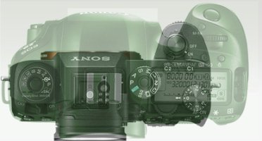

Here is my Nikon FE on top of my Panasonic GH4 (which is smaller than the GH5)
Flange focal distance:
Nikon F = 46.50 mm
Micro43 = 19.25 mm
For reference:
Canon EF = 44.00 mm
Yet look at the actual thickness of each camera. The GH4 is actually thicker and the Nikon has a mirror box in it.
It's really the electronic components inside that make more of a difference in size than the flange focal distance.
So I say, keep the same lens mount and instant compatibility with all the existing lenses and just work on making the electronics smaller. This obsession people have with shorter flange focal distances is not necessary.
The rear LCD seems to be the biggest offender to the thickness of modern camera designs and while everyone wants a thin camera, they're not willing to accept a DSLR without a colour LCD.
I'm not familiar with Panasonic's offerings, but it looks like the screen of your GH4 is a vari-angle LCD which distorts its dimensions even further.

Aaron D said:
Why in the world does a shorter flange distance MAKE THE GRIP TOO SMALL?! How are the two even related? Canon is pretty clever I think. Is a comfortable hand grip on a new-design-from-scratch camera body really such an impossible leap?
1000% agree. Grip and flange distance are completely independent. Go chunky on the grip, b/c people will bolt f/2.8 zooms and f/1.4 primes on it regardless of the flange distance.
Aaron D said:
Sony makes what looks to be a pretty good grip on their A9 (admittedly have never held on in-hand)…
Oh: hell no. The A7 I,II,II bodies / A9 body have an unmitigated disaster of a grip if you want to put a proper fast FF lens on it. The grip is too small to wield heavy lenses (not massive superwhites, I mean f/2.8 zooms, f/1.4 primes) and, critically, it's too close to the mount! Compare and contrast below. Simply put, it was designed to create that compact footprint with a slower prime. That they continue to grandfather that disaster of a grip through 3 generations now implies that they aren't serious about courting pros yet.
- A
