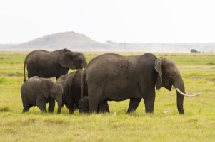

I got the Canon EF 70-300 f/4-5.6 IS USM as a last minute solution to an order screw up (had ordered the 100-400L), and I was stuck with this as my only telephoto lens for my safari in Kenya. I certainly didn't expect wonders, and sure enough I found it to be a quite soft lens if lighting conditions aren't perfect. Now I'm wondering if that's the average for this lens or it's just my copy, how can I determine that? I think I'll be keeping it until the new 100-400L comes out, so it'd be nice to have it working properly, within its limits. It also has a slight front focus problem, how does Canon handle this problems? Can I send it to fix under warranty?
Attached there's a photo example, thank you for the help!

It's a bit difficult to judge, as pointed out. However, based on the appearance of the DOF in this shot, i.e. how it gets unsharp in the back and front, indeed it looks as if you have some front focus.
I would test the lens using life view (with 10x mag) if you want to see how sharp your copy is.
Also, did you use a FILTER with that lens??? is so, which one?
Without the EXIF data it is impossible to say, but there is nothing sharp in your image, if you had a good fast shutter speed, the vehicle was stationary, no crappy filter, it isn't a huge crop, etc then I'd say you have a soft lens, but to test that you need to put it in a tripod and do some controlled exposures in both manual and auto focus. It does not look like a micro AF issue as nothing is sharp, not meaning you don't need to do micro AF, but that the issue you have is masking any additional micro AF issue.

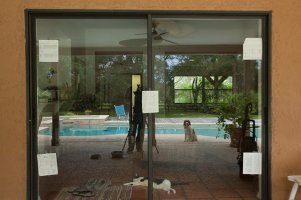

Here is how I test my lenses for sharpness and element misalignment. This series showed me extreme misalignment at 35mm with a 16-35, even at this size you can see the image right paper is more blurred than center and left.

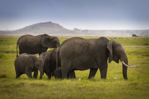

And a little sharpen and rework on your elephant shot too.
You're right, I didn't give enough information.
Shot with Canon EOS 7D
EFIX data:
f/6,3
1/1000 sec
ISO 800
275mm
The vehicle was stationary, it's almost not cropped at all and I had on the Canon protection filter.

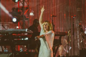

Most of all on the long end, there's nothing sharp about the lens, especially when you're not stopping down a ton! I had to shoot Philadelphia's Welcome America Festival from a press platform over 100m from the stage, and this was my only long lens at the time. Here's a shot of Grace Potter @300mm, f/5.6. Not sure what I was going for with the editing but you get the idea.
