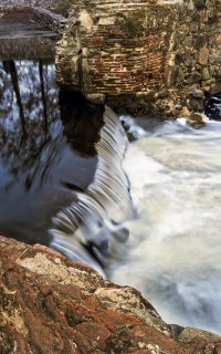

I know there are a multitude of factors affecting the process in shooting in the 5D Mark III's expanded ISO 50;SNR, DR, electronics, physics, optics, post work in software, brand model specifications and hype, third party testing...on and on.
Many of those topics can be throughly argued far beyond my understanding of technical issues at hand, but actually prove nothing but a great debate topic amongst experts.
I think the real test of whether shooting @ ISO 50 with the 5D MKIII is usable or not is to actually go out and to test it yourself, not endlessly beat it to death without a single exposure to evaluate.
Admittedly this was shot on an overcast day without glaring highlights, and I really wanted to accentuate the waterfall's movement, so I used a Circ. Polarizer not for reflections control, but to add 2+ stops exposure in addition to lowering the ISO to 50. I don't yet have a decent ND filter set to accomplish the same thing.
I was please enough with the results shot at Mission Trails Park Old Padre Dam, built around 1800 and of the first Spanish irrigation structures in California on the San Diego River. No it is not Old Man river, but yes we have a flowing river here!
Certainly open to opinions and criticism. Specs: 5D MKIII 17-40 f4, ISO 50, @ 5 sec , @f18

Nice picture. I like the brick wall and the flow of the water.
I have a few questions:
[list type=decimal]
[*]Did you shoot raw or JPEG?
[*]Your file name has the word "edit" in it. What editing did you do?

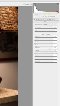

We, or rather I, by now feel:
a) I was mistaken about noise advantage of ISO 50.
b) ISO 50 causes loss of highlights.
c) I will not use ISO 50 again.
I examined the histograms of the two shots I posted earlier as test.
Although I exposed both shots equally, (And I cant be convinced otherwise) but the histogram on the 50 ASA shows that whites are clipping.... What does this mean? To my non technical mind it says: At ISO 50 the dynamic range gets reduced. Am I wrong?
I am not agree or disagreeing with many posts here, just exploring. Actually I do not even understand many posts fully to argue! :)
[list type=decimal]
[/list]
I always shoot Full sized Raw for Landscapes @ 14 bit, Initially catalogue and process in 16-bit Adobe ProPhoto in Lightroom 4.3 using Process version 2012/ACR7, which in and off itself offers superior Highlight Recovery at any ISO. Image then is transferred to CS5 for further tonal edits, touchups, etc., and when it returns to Lightroom, it appends the filename with -edit.xxx. I export that to a JPEG for posting.
This is a real world workflow for producing printable imagery, not mind numbing photon counts in test images.
Pixel peepers might claim that the Lightroom and Photoshop edits obscures the Highlight clipping problems of shooting @ ISO 50. Perhaps so, but I dont know of a real world digital workflow that doesn't include noise reduction, sharpening, and highlight/shadow clipping control to produce not only a workable and viewable, but printable image.
Does anybody print unprocessed RAW images out of the camera?
In the end isn't it all about getting the final product looking the the way you want it to appear?
A photographer let alone a lay viewer of a print is never going to say "Oh my God this image has 1/2 stop too little DR, he used HTP", or "the sensor collected X Photons"
If one of my images had serious blown out highlights or shadow noise, and is therefore unacceptable, I simply wouldn't exhibit it.
jpthurston said:
rpt said:
[list type=decimal]
[/list]
Thanks. I am still learning the fine art of digital editing and so I am curious. I have LR 4.3 but not PS... As for pixel peeping or counting photons (or counting Half The Photons) I don't really care for that personally. To each their own...
