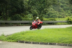

Hi again. I am planning to go malaysian Motogp in Oct so I figure I would go out and practise first on my 24-105 before I dive in and buy a 70-200 f4.
BUT, most of my shots came out blur AGAIN.
I was trying to 'pan' a little. exif should be available
any and all comments and suggestions welcome

What focus mode were you using? If using single-shot AF with an object moving that fast toward you by the time you hit the shutter he will be out of your focal plane. There is no motion blur on the front wheel's spokes, SO the shutter speed should be enough at 250. Could try bumping the iso to 800 and knocking the f-stop down a stop, see if the increased DOF helps. Hope you figure it out!
Feb 24, 2012
577
i'm not at my "real" computer so i don't even know how to look at exif data with this thing. Are you using the servo focusing mode? what camera body was this shot with? mostly the thing that i see is that nothing is really in great focus. perhaps from your panning? looking at the shot i wouldn't have thought that there was much panning needed. he's not really moving across the frame or anything. i don't have a 24-105f4IS, does it normally handle panning okay? i bet it does, just wondering.
also, can you take me with you to the race. one of the last with Rossi on the lame duck ;)

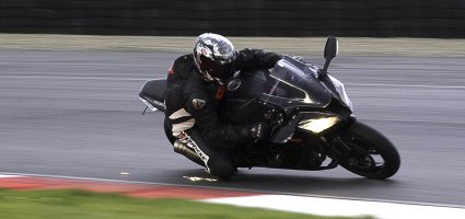

I have shot a lot of bikes this summer. I am by no means an expert, but I normally shoot in AV, AI Servo, and use the AF-ON to track and the shutter button to take the picture. I use Shutter priority when I am attempting to get real panning blur, but this is hard as they are passing me in more than 200 km/h. This picture was taken on Thursday using a borrowed 1DX and the Canon 24-70 F2.8L II.
If you have the chance (and get permission from the ones running the track, try to get a good spot on the track, in a curve where you both have them leaning over with the knee down, also where you can catch them speeding away.
Love the sparks, well done.

Menace said:
Thank you :) I think they use titanium cups on their knees to acheive the effect

now that i'm on my usual computer i can see things a bit better. I don't have any exp with that lens, is that level of IQ normal at the long end of that zoom? it's just that it really would seem to me that 1/250 should be enough to freeze the action, yet nothing looks all that great. isn't not quite apples to apples but from my past exp with panning shots i had to get the shutter speed well below 1/250(dirt bikes at a much slower clip, but at a MUCH closer range) more like 1/50 or slower usually to get a good bit of movement. but there are many variables.

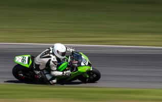

Hi
I shoot a lot of motorcycles (and race cars) I primarily shoot with 7D and a 7-200 f4 with a 1.2x converter.
I shoot continuous focus with my a focus point selected to that it will line up with the front of the bike (or car).
I mostly in Tv because it is more important to control shutter speed than aperture value. The key to getting a great panning shot is slowing the shutter speed as slow as possible. This is dependent upon how stable you are when panning. At first you are going to need a faster shutter speed say 125th but with practice you can get down to a 60th. This is obviously dependent on how fast the motorcycle is going. The faster the bike the faster the shutter speed.
The second key is to use high speed continuous shutter trigger. This way when you fire of a burst of four or five shots you will get one in focus. When you get good at panning so the bike stays in the same relative position in the view finder, you will be able to pick off a single shot.
I have way too many examples of panning shots so I will just give you the link to my site and you can see as many examples as you like. The EXIF data should be visible on most photos.
www.KingMotorsportPhotography.com
Let me know if you have specific questions.
