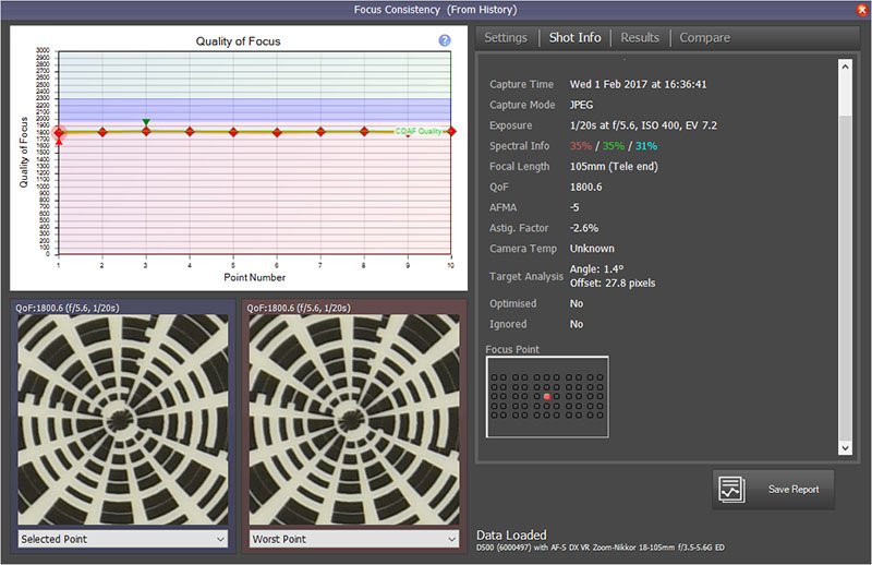

If You happen to use Reikan Focal, there is a AF consistency test that can be run for each AF point that gives values that you could include when you send the lens in to Canon. Focal does a lot more than just AFMA. Try it with just the center point to see if it shows the issue.
https://www.reikanfocal.com/features.html#afc
"Autofocus Consistency How repeatable is your autofocus?
When you half-press that shutter button and your camera beeps, where is it really focusing?
The Autofocus Consistency test will automatically defocus and refocus a number of times and show you just how consistent the focus point is.
This tool can highlight camera and lens problems, including degradation of focus drive mechanism. Combined with the FoCal Comparison Database, you can know if you've got problems coming."
