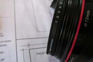

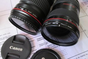

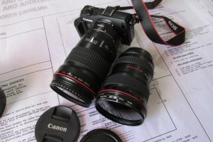

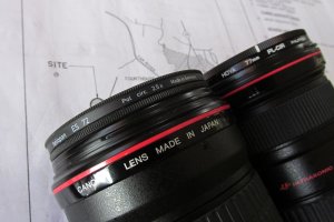

Dear Sir/ Madam.
Yes the Most stupid question that I do not know and try to ask my friend( At my Home town Camera Clubs) for 2 years--- And No one know.
About time that I must ask my dear friends in CR, and all of m6y Teachers in CR.

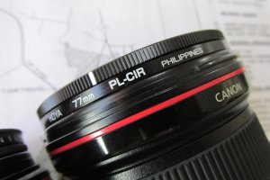

Yes, My Hoya Cir. PL , which they have Mark/ White mark at the outer ring, And That indicated the Sun Location for the Darkest Sky for PL effect and I can turn the outer ring to match the location of the Sun.
___ Big BUT, My high cost Heliopan ES 72 POL. Cir. 2.5X have Number 1, 2, 3,----To Number 26 at the Outer Ring of Filter, and NO ONE ( All of my Club friends) know, Plus I ask the Camera shop that I buy from---No one know----Ha, Ha, Ha- if Number 1 thru Number 24 ---I can guess that the hour of the day---How about 25 and 26---Might be Beer Time ??
Yes, Sir, For Helliopan Cir. PL, I use my eyes to point out the darkest Sky with no problem, But WHAT ARE THE NUMBER 1 to 26 for ?
Thank you, Sir.
Surapon
PS, If you see the photos below, That Indicate that I love my Canon EOS-M----Ha, Ha, Ha.

Hi Surapon, the numbers will be marking a scale of the polarisation axis, so just a reference to where you have it set.

Hi Surapon, I'm guessing that number 1 will equal the same axis as the White mark on the Hoya. I'm assuming the numbers go half way around the lens. Looks good anyway !

No It doesn't work like that. the polarisation is not time of day dependent but where your lens is in relation to the incoming light so if you are changing between 2 or 3 shooting positions constantly the helliopan allows you to remember which point is right for each position more easiliy without having to spend alot of time trying to optimise the polarisation through the viewfinder each time. Does that make sense? I hope so. Its just a arbitrary reference scale not and absolute reference scale related to anything specific.
Description from B&H website:
One of the "wow" factors of this filter are the index markings on the edge of the filter ring. This allows you to hold the filter up to your eye, choose a point that you like for polarization, replace the filter on the camera and simply rotate the ring to the chosen mark.

Hi Surapon,
I'm not sure why you need to mark the inner ring when it's attached to the camera?
A polarizer only has one piece of glass that turns with the outer ring.
A variable neutral density filter has two glass elements, one fixed to the inner ring and one that rotates with the outer ring.
The amount of polarization only depends on the angle of glass element (outer ring) relative to the sun.
If you want to work out which number corresponds to maximum polarisation, stand with the sun over one shoulder (90% to the direction you are facing) and rotate the polarizer until you get the deepest blue sky. Then see which number on the ring is facing the sun. This would be equivalent to the single mark on the Hoya ring.
If you do this with the polarizer off the camera, remember that it will only work if you look through it from the rear (threaded) side. You wont see any polarization effect if you look through it from the front side.
Phil.

Yes, Sir/ Madam, I find out :
1) As Mr. Mt Spokane teach me that : use my Finger form as the hand gun , poit the point finger to the subject, and the thumb at the sun location = we will get the maximum PL, Effect/ Dark blur sky with out use the cir. PL. Filter/ by natural effect.
2) For Hoya = the White mark at the Outer ring are great for the Maximum PL. Effect if the White Mark point to the location of the sun.
3) For Heliopan filter = The Maximum PL. Effect ( make the most dark blue sky) at Number "1" and at Number "26"-----If I trun the outer ring start from Number 2 to number 12, at number " 12 " the sky will be the most light blue, and start getting dark if I turn from 13 to the most dark blue sky at number " 26"-----Yes, Sir, I now Agree with our friend Mr.Phil that These Numbers from 1 to 26 on Heliopan are " WOW " Factor of high cost German made Cir. PL. filter that we can remember to use in the future shot ---Not to Light and not to super dark---Just perfected exposure in our creation/ our Idea of the look of the photos.---Yes, My number are 6 and 18.
