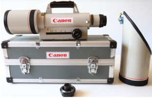

swkitt, explain the availability of the FD 150-600 f5.6, a twenty year old manual focus and aperture lens that costs $3,000-5,000 secondhand then. A 107mm front element is not in the same price bracket as the Sigmas and Tamron, it is a completely different league.

You clearly have no comprehension on optical physics, the word telephoto means a lens shorter than its focal length, and has been around since 1611. https://en.wikipedia.org/wiki/Telephoto_lens
Front element equals focal length divided by aperture, there is no way around that. https://en.wikipedia.org/wiki/Aperture
The FD 150-600 f5.6 was a premium lens that still fetches very good money and video users love it. An EF 200-600 f4.5-5.6 will have AF and IS and be a premium lens, it can't not be, and video users will love it, more-so than the 200-400 with TC.
