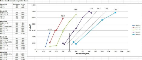

Hi,
some months ago, before the 100-400 II was released, my hope was that Canon will replace their old 100-400 with a 200-500/600 whatever. I thought Canon marketing would have expected Tamrons and Sigmas 150-600 lenses and will make something similar.
My question was: what could be the price of an very good L with 500 or 600mm.
I made the graph below... and my hopes for a "cheap" lens were gone. But i still hope they will deliver a 200-500 5.0-6.3 below 3000€.
5.6@600mm... L-quality... 1500 $/€... i want to believe.
I'm sure you will understand what i tried to show with the lines.
BTW: Sorry for my bad english :(

swkitt said:

lightthief said:
Hi,
. Excellent work. Seems very convincing.

In my mind I had done the figures projection and therefore had a mental chart very similar to what lightthief has provided (well done, lighttheif). So I know that a good, quality lens (especially a zoom) going to 500mm or more is neither going to be cheap, nor small.
