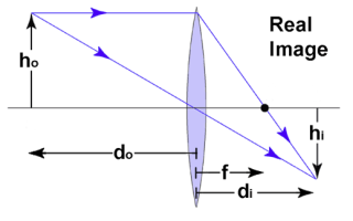

Does this lens not project an image smaller than Canon's APS-C sensor, which is smaller than everyone else's APS-C sensor?..
*Edit* along with the other two examples highlighted by Wizardly...
The normal image height for a Canon APS-C image circle is 13.66mm. 'Image height' is actually the radius of the image circle, slightly more than half the diagonal measure of the sensor. For a FF sensor, the image height in a lens patent is generally 21.65mm.
Well of cooourse that's what "Image Height" means, how silly of me to assume it referred to the height of the image ;)
Thanks for clarifying, Neuro! Any idea, er, why... why this measurement which is smaller than the height, nevermind the width, of the recorded image is used? As someone whom this is a new concept to: it's kinda' ridiculous :p

Because lens elements are circular, it makes sense to use the radius of the circle as a specification, rather than some arbitrary chord. What if the lens was intended for a sensor with a 4:3 or a 16:9 aspect ratio (compact, m4/3, video, etc.) instead of the 3:2 ratio used in most dSLRs? That would render the image height impossible to translate into a meaningful number without also specifying the sensor format. Thus, specifying a measurement that's unambiguous is quite logical.

I'll admit that there's logic there, Neuro, but who's the idiot who decided that "Image Height" was an appropriate name for it? It seems as logical as taking and misapplying to this attribute any other term, like Depth of Field, Flavour of Pie or Image Height... oh, wait, that's what they went with ;)
I'm aware that projected image circles aren't necessarily usable and go wildly distorted at the edges, geometrically and otherwise, so is the "image height" in this context relative to the circle that a manufacturer is proud to consider "usable", or the circle of projected light in its entirety, fuzz-and-all? If the former, yeah, I can get on board with this being a worthwhile measured attribute, " Radius of Image Circle ", alas Image Height just isn't going to sit well with me, just like 1" Sensor ;)

The 'idiot' was probably some optical physicist lost in the depths of time. Remember those 'thin lens approximation' ray diagrams? It's image height as in the largest value of hi (height of image, image height) that can be projected onto the image plane. In patent terminology for a lens intended for an APS-C sensor, it's stated as, "The optical system of this embodiment has a maximum image height of 13.66 mm."
