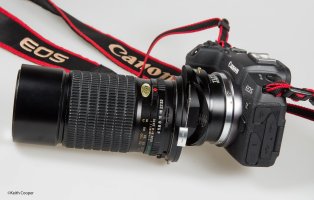

As to M645, see this article...
Fotodiox tilt-shift lens adapter - using MF lenses on a mirrorless camera
Review of the Fotodiox TLT ROKR tilt-shift lens adapter for mounting medium format lenses on mirrorless cameras. M645 to Canon RF and M645 to Nikon Z
Here's a 210mm f/4 with 15mm of shift and 10º of tilt
