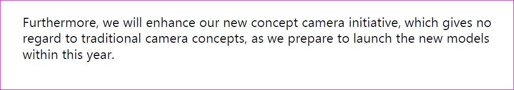

We have been wondering what Canon meant when they said that they would launch a new camera concept initiative this fall. Perhaps this is related?
