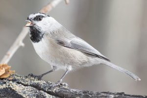

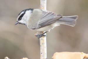

Not scientific at all but shot under identical conditions using the same 100-400 lens at 400mm with identical processing, f/8, 1/1000, and iSO 500. The first image is the 1D MK IV, the second is the 7D MK II. Make of it what you will. I used auto-ISO by the way, on both cameras. Distance to the subject is around 10-feet.

I have already beat this one to death for myself. I started the comparison the day the 7D II was released.
The 7D II has more resolution, little birds like the one above you can get a bit more detail. In this instance it is an advantage.
There is only benefit in focal length limited situations like this. If no cropping is required with the FF or 1D IV, you are better off with those two.
Color, exposure and such there is no difference once PP with any of the three bodies. You would be hard pressed to tell the difference in pictures equally prepared. Resolution with cropping is one exception. Noise of course is better with the FF or 1D IV sensor.
A bird that fills the frame will be better on the 5D II or III.
But little birds like above almost always are cropped.
The 1D IV has the better AF system. It drives my 500mm faster. So far the 1D IV has more accuracy. I sent the 7D II in for warranty on the AF system, just got it back and headed to the woods this weekend to see if it performs a bit better.
If the AF system is as accurate as the AF system on the 1D IV, the 1D IV is still better because of the speed it drives the big prime. Maybe if you are using a 100-400mm you wouldn't notice as much difference.
I have both and will keep both. If I want to take images of BIF I would grab the 1D IV, if for no other reason I have a high level of trust in the tool. I have been using the 7D II for static to get a bit of resolution boost.
