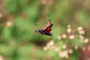

Emperor Dragonfly hovering. R7 does not lock on nearly as fast as does the R5 with the RF100-400mm or RF100-500mm. It was rather frustrating at times. More input from other users on BIF would be good. Battery life is really good. Here are two shots cropped and 1 pixel = 1 pixel of original.3R3A0928_Emperor_Dragonfly_flying_Crop.JPG3R3A0726-Emperor_Dragonfly_PS_tif_dn_sh.jpg
