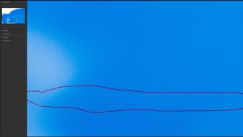

Just to clarify, I'm not experiencing a sensor dust issue. I am experiencing lines that look like brush strokes in two areas of my sensor. These lines appear at f13, and are visible throughout the rest of the aperture range.
Do you have an image you can post up to show what you're experiencing? If you're still seeing only dust it might just be you need to have the sensor cleaned yet again. It's hard to get it spotless, and might not be worth the effort.

Just to note, the CPS loaner 1DX II also exhibits the problem, although not with the same frequency throughout the frame as mine. The loaner has one big long line towards the bottom of the frame. I've called CPS and told them about it, and they asked for sample images from it too, which I've provided.
Anyways, I'm not sure what will be done/what can be done -- they might chalk it up to a non-issue *Shrugs. Anyways, Canon is looking into it and the people I've dealt with on the phone have been extremely pleasant to deal with. :)
Here's a screen shot of the line on the loaner at f/13. It obviously becomes more pronounced at smaller apertures:

I received my camera back today. Canon Canada replaced the whole sensor. They acknowledged that there was a problem in the production of my sensor, and the CPS agent insinuated that they've now seen it on a few others, especially now that I have alerted them to it.
As far as what the actual cause is - ie, something wrong with the sensor stack?? - they didn't specifically say.
