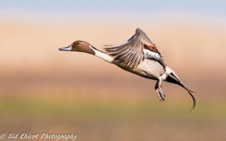

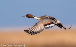

I think your issue with the duck photo is a combination of possibly the DOF of the lens, but mostly the shutter speed used. Duck wings beating aren't as fast as a hummingbird's, but especially when they are taking off, they beat pretty darn fast. A few years ago, I took a nice sequence of several shots of a pintail taking off. As the lighting gradually changed when it took off, my shutter speed went from 1/2500 to 1/5000 over the sequence since I was in aperture priority. At the slower 1/2500 speed, the wingtips were slightly blurred much like yours. At the faster shutter speed, they were much sharper, even with the same bird. I don't necessarily think the bit of blur is a bad thing, in my opinion. It helps to convey the impression of movement.

Wonderful photos. Really nice!

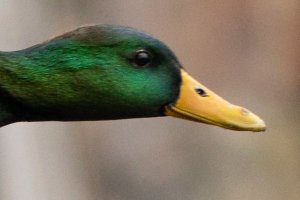

It’s not the wings I’m concerned about, but the head. Each wing is outside of my dof, but not the head, it’s dragged like motion blur, and since both wings are pretty equally blurred and the head is right between them, it should be sharp. Focus locked and tracked the head.

Maybe this is better.
So, what shutter speed is this? Do you recall if IBIS was on or off? Is this maybe a shot from a series, where you could share with us if all shots from the series look like this?
What it reminds me of, is the blur I get when leaving OS on with my Sigma 150-600 mm ca and using shutter speeds over 1/1000 s. It seems that under such circumstances, the OS becomes a source of motion blur itself, so I always end up with slightly less sharp shots compared to using no OS when I shoot moving subjects. That's on an 80D, without any customization of the OS through the dock. So maybe IBIS does something similar for you. But in your OP you specifically mentioned that it doesn't impact your issue with blur...
I’m 85% sure the IBIS was off , I’ve always had a habit of turning it off for ducks. Shutter speedwas 1/2000s. I had a few more in the series, but this was the sharpest, and it looked spot on in camera of course, so I deleted the others that was obviously not worth keeping.
