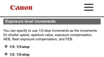

Canon cameras use 1/3 or 1/2 stop increments, depending on the selected setting.

If you look at the 1/3-stop scale on the wiki page you posted, f/1.2 is 1/3-stop faster than f/1.4 as you say, but if you look at the 1/2-stop scale on the same wiki page, f/1.2 is also 1/2-stop faster than f/1.4. How can f/1.2 be both 1/3- and 1/2-stop faster than f/1.4 at the same time? It can't and it's not. That's why the wiki page indicates those are 'typical f-number scales', i.e. approximations.
With 1/2-stop increments, f/1.2 is one full stop faster than f/1.7, as shown in the graphic I posted and in your wiki link. Therefore, the difference between f/1.2 and f/1.8 is more than one stop.

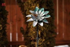

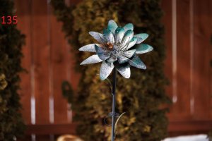

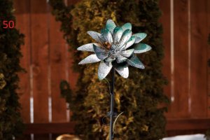

Just for some bokeh fun, I compared shots between RF 50 f/1.2, 85 f/1.2 and 135 f/1.8 lenses. All shot from same position, with the 50 and 85 cropped to match the 135.
Interesting to note the 50 and 85 have pretty much the same warm tone and the 135 is a bit cooler (on my monitor).
85mm/1.2=71mm or so. 135mm/1.8=75mm. So their physical aperture, or "entrance pupil" is basically the same, so a crop of the 85/1.2 down to a 135mm angle of view will have just about exactly the same bokeh as the 135. And indeed, the 135 vs cropped 85 show more or less exactly the same thing.
While f/1.2 sounds big, on a 50mm lens that's "only" a 40mm aperture. And bokeh is a question of area, or aperture SQUARED, so the 85 and 135 actually have about 3x the bokeh, even if you crop the 50mm shot to the 85 or 135 field of view.

Yep, it was interesting to see how that worked. The 50 definitely can't hang with the 85 & 135, so I see what you're saying about a 35 f/1.
Thanks for that comparison.
Quite interesting.
