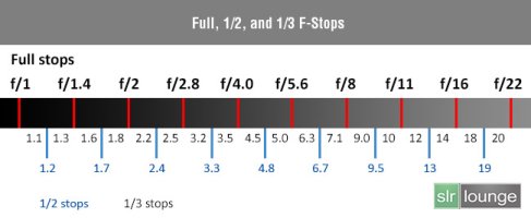

I went with the RF 85/1.2 in the end, and I do not regret it. It produces very sharp images, and its f/1.2 has helped me out so many times. That's over a stop wider than the 135/1.8 and over two stops wider than the 70-200/2.8.
However, from my experience its autofocus is definitely not as fast as the 70-200mm f/2.8.
It’s not “over a stop” it’s one full stop, full stop:LOL:
