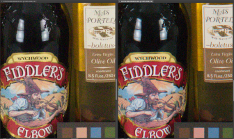

In case anyone is interested, here's the 7D2 and NX1, again with no sharpening or NR and the 7D2 scaled up. I would say the 7D2 here is a bit worse.
Hmm, I am not sure what your using to process, but you are getting radically different results than I am. This is from ACR in PSCC...I simply opened both ISO 6400 NR0 RAW files without any edits in ACR, downsampled the NX1 to the 7D II dimensions, and aligned the images as layers, then cropped the following area:
There appears to be visibly less noise in the NX1 image. The color also appears to be richer, less washed out. The differences in noise can be most clearly seen in the fiddler himself, in the glass of all the bottles, and in the black border and several swatches of the color checker card. The primary detractor that I notice with the NX1 image is the darn CA.
To see if my feelings about the images were correct, I saved the cropped areas as 32-bit TIFF and ran both through PixInsight's statistics tool. I created previews around four areas for statistical testing, and propagated those previews to the other image (so exactly identical regions of each image were compared):
According to PixInsight, the noise on the black part of the Fiddlers Elbow bottle, just under the label, has a standard deviation of:
7DII: 0.048 (R), 0.048 (G), 0.051 (B)
NX1: 0.037 (R), 0.037 (G), 0.038 (B)
Statistically, the NX1 DOES have lower noise. I also checked the maximums:
7DII: 0.325 (R), 0.325 (G), 0.349 (B)
NX1: 0.278 (R), 0.294 (G), 0.302 (B)
The NX1 also has lower maximums, so the black glass there is indeed deeper and richer, with less noise. The preview on the right-hand bottle had the following standard deviation:
7DII: 0.087 (R), 0.061 (G), 0.042 (B)
NX1: 0.077 (R), 0.055 (G), 0.039 (B)

7DII: 0.046 (R), 0.042 (G), 0.039 (B)
NX1: 0.037 (R), 0.034 (G), 0.033 (B)
In every preview, the noise levels of the normalized NX1 image are lower, by a pretty decent margin (enough for the difference to be detected visually.) I also checked the noise levels in the preview around the red part of the fiddlers bottle label:
7DII: 0.067 (R), 0.045 (G), 0.050 (B)
NX1: 0.057 (R), 0.044 (G), 0.043 (B)
Not as much difference in the green and blue channels, big difference in the red channel. That explains the loss in color fidelity with the 7D II...again, more noise, higher standard deviation, so some of the pixels are reaching a brighter/lighter (and therefor, according to color theory, less saturated) "red" tone.
It should also be noted, for maximum clarity here, that the 7D II is at a slight 'advantage.' I downsampled the NX1 image as a whole directly to the same image dimensions as the 7D II image. That did not, however, normalize the objects within the image. It can be clearly seen in my GIF that the NX1 objects are a little larger. This is probably the result of a framing discrepancy. Technically speaking, for a properly normalized test, I should make the objects the same size. If I did so, that would be downsampling the NX1 image even more, thus reducing it's noise even more in comparison to the 7D II.
Since there's only one ACR update that can process RAWs from either camera, it's pretty obvious what I'm using ;)
I turned off sharpening, LNR, and CNR, and then scaled up, just like I said. I want to see what comes off the sensor. And I didn't want anyone replying that I made the 7D II look better by scaling the NX1 down to its dimensions.
Your results are not "radically" different from my 7D2vNX1 screenshot. Are you confusing that with the 5D3vNX1 screenshot?
The NX1 appears darker in both our samples. Not sure why. That affects perception of noise and color, even more so at a smaller scale, and would affect any statistical analysis. That said, I would give the edge to the NX1 by a hair, but not enough to matter when using NR and other settings in ACR and PS.
More to the point, the NX1 is not equivalent to the 5D3, and the difference there matters.
You're splitting hairs. No one would ever know the difference in a processed print. The NX1 has the expected IQ for a modern crop sensor, but it does not leap ahead of anyone else. In fairness, neither does the 7D2, though I think it does gain a little on the 70D to put it on par with the competition in terms of high ISO.

jrista said:
That's my point. Statistically, the NX1 has lower noise, which leads to richer color and contrast (hence the reason the parts of the NX1 image that are supposed to be dark look dark! :P)
It does have very slightly lower noise, but that is not the reason it's a darker image which is what leads to the difference in our perception of color and contrast.
Again I'll note that with color NR the 7D II ends up looking a tiny bit cleaner, i.e. lower luminance noise. But in the end neither requires a different work flow or more work. Neither has "better data."
My perception is a bit different and I tend to agree with Jrista.
My comparison of RAW samples (no NR at all - no Chroma no Luminance NR) at DP comparison tool which I posted a bit earlier shows that at ISO3200 NX1 RAW samples visually look better/cleaner/crisper than ones from 7Dm2 and as I also noted NX1 noise pattern is visually better and more pleasant than noise pattern of 7Dm2. NX1 is less blotchy , has a bit more higher noise frequencies and a bit more regular - so should be easier to clean up compared to 7Dm2 . Blotchy noise pattern from many Canon Cameras is something that was always irritating me as well as low performance at low contrast details in red channel - just smearing them away. 1Dx fortunately is better in this respect though also suffering a bit.
Also on this samples NX1 is not downsampled/normalized to 7Dm2 resolution which would also add more difference in favor of NX1.
