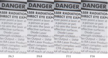

J.R. said:
a large section of the buyers of the Tammy will end up using them on the APS-C cameras where diffraction sets in real early - sometimes as soon as f/6.3. If you were to stop down to f/11, how much do you think the images will suffer in sharpness?
I did that test several days ago....
Here are the unprocessed bit-level crops for the Tamron 150-600 at various Fstops using a 60D
F11 is ever so slightly better than F8

Don Haines said:
Indeed they look better. I'm now tempted to try one when it becomes available in India.
