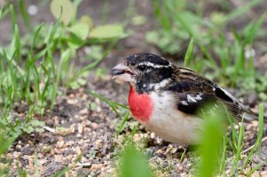

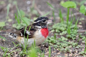

assuming all settings are the same in both photos, and focussing is spot on for both, I would say the first one is the Canon 400 DO - is just 'crisper' like it has more contrast, but I agree the difference is slight.
I was looking to compare the shades and detail in the blue but unfortunately it is only really visible in the second image.
It's pretty clear that this is the Sigma: http://www.canonrumors.com/forum/index.php?action=dlattach;topic=1280.0;attach=166893;image
There is a noticeable drop in sharpness and contrast.

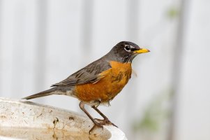

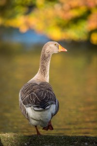

The test conditions were not exactly fair as the Sigma photo done last month was hand held at 1/400s whereas the Canon yesterday was hand held at 1/1600s. Speed does make a difference for these extreme crops. I'll post another comparison I did last year with different lenses.

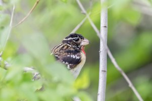

In case you think I've given up on on the 5DSR + 400mm DO II + 5DSR here are some sharp ones taken today. Kingfisher, wagtail and barnswallow.
