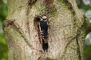

Hi Alan, dug up a picture I shot a year ago; same tree - same species of woodpecker
Portrait shot is 100-400 II at 400mm, f/7.1, 1/640s, ISO3200 (slightly cropped)
Landscape shot is 60-600mm at 600mm, f/6.3, 1/200s, ISO1250 (full image)
Both on 7DII
184929184930
Below I took 1200x1200 pixel cut-outs around the birds head; so as equal as possible comparison (i.e. 1200 sensor pixels each)
100-400mm:
184931
and the 60-600mm:
184932
I think you'll agree that there is more detail in the 600mm shot.
Sure the ISO3200 does not help sharpness on a 7DII but nonetheless...
Both on 7DII
100-400mm:
and the 60-600mm:
W.
There is, of course, more detail from the 600mm lens, especially as it was used at less than half the the punishing iso of 3200 for the Canon lens. As I wrote earlier, I would have used the 100-400mm at f/5.6. And that was the point, using it wide open so as it to lessen the iso required in low light. By using it at f/7.1, you have taken it above the DLA, and have raised the iso 2/3rds of a stop. Also, by choosing 1/640s rather than 1/200s for the Sigma, you have raised the iso by another 1 2/3rds stops. I always tried to keep the iso of the 7DII to 800 or less for static shots because the noise starts to lower resolution above about 640.
