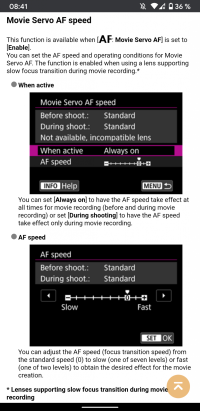

For the R at least, this is setting you should look for, I think:
Should be similar on the R5.
Have you adjusted it already?
Yes, I did it in the first minute. After searching for another half hour, I found other settings for tracking the object, keeping it in focus, and set everything to maximum. And nothing happened, it feels like (((
