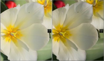

bchernicoff said:
Here is a quick screenshot from Aperture. I was shooting RAW+JPEG. Photo on left is in-camera JPEG (one of the better ones) and photo on right is CR2 converted to DNG. Notice the missing detail in the white petals.
It looks like the in-camera processing is adding lots of contrast to add more color, contrast, and "pop" at the expense of detail in the midtones. I agree that it seems quite aggressive. Just out of curiosity, where did you have the jpeg presets (contrast, saturation, etc) set at for this shot?

This seems pretty symptomatic of the DPP issue, and I bet that is indeed the problem.
As someone else posted earlier, Bryan C over at the-digital-picture had this to say:
http://www.the-digital-picture.com/News/News-Post.aspx?News=2142
Another fellow returned his because he encountered the exact same problem (but did not know the cause at the time which has been revealed to be the above).
My apologies if you don't use DPP and already use the DNG converter, and are still getting sub-par results. In which case, I hope things turn out better if you exchange for another copy.
The bottom line is, this is fantastic camera and I really like using it. Converting to DNG proves the sensor and the RAW files have the detail, we are just stuck dealing with a firmware/software issue...which sucks, but is not the end of the world.
To anyone concerned about their camera: try converting with the Adobe software first. If you are still not satisfied do some tripod Live view manual focus shots to make sure you aren't having a focus calibration issue. If the result is still bad, then maybe you have something to worry about.
